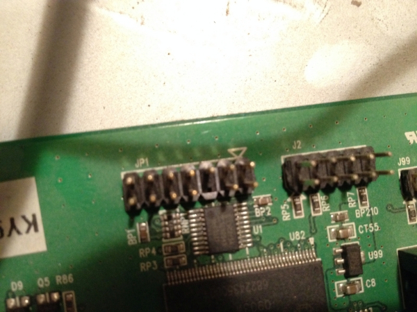

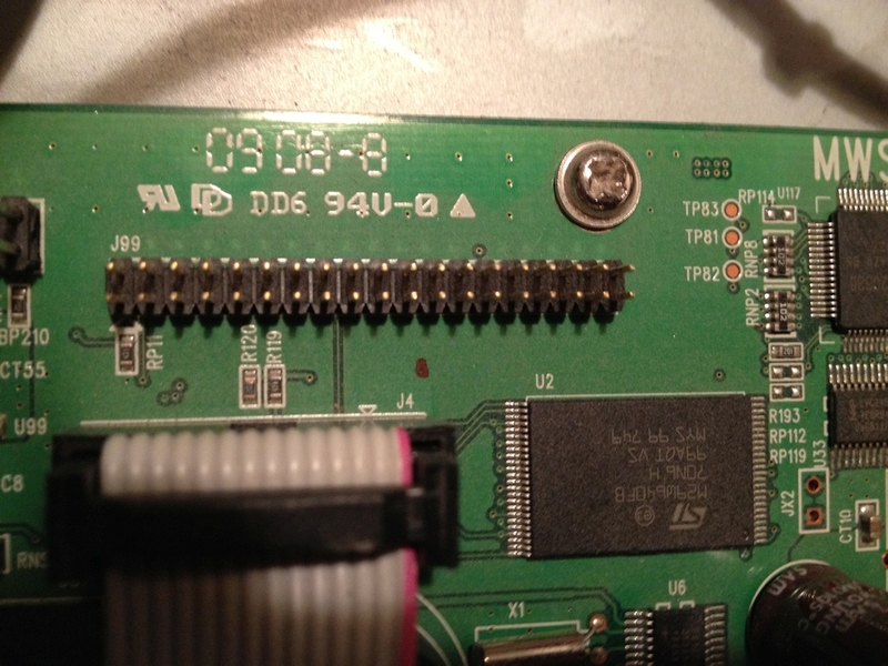

Сообщение quiksilvr » 02 фев 2017, 13:08
these are the available headers on the board. plus the rs232 on the back of unit
Re: dvr firmware
Сообщение iTuneDVR » 02 фев 2017, 14:23
quiksilvr писал(а):these are the available headers on the board. plus the rs232 on the back of unit
if rs232 is present on back of unit, let's connect to him...

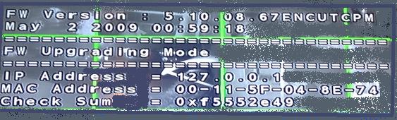

Сообщение quiksilvr » 03 фев 2017, 14:50
with the dvr unplugged, if i hold down (setup) & (enter) buttons on front panel, then plug in power, it goes into "firmware upgrade" mode.

Re: dvr firmware
Сообщение iTuneDVR » 03 фев 2017, 16:18
it's old school DVR? ;)
