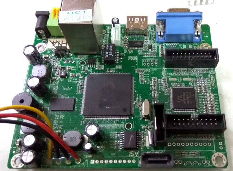

Сообщение hack2003 » 21 апр 2017, 13:09
пришел включаться есть цветные полоски , подозреваю слет прошивки есть dump
Проц hi3520 флешка W25Q128B
пробывал не сколько прошивок включая http://www.dh-vision.com/main/firmware/ ... 20(H,%20HE)/General_DVR5X04HX_Eng_N_V3.200.0001.8.R.20140624/
дамп https://...
в консоли пишет
Код: Выделить всё
U-Boot 2010.06-svn109 (May 20 2013 - 09:16:41)
DRAM:  256 MiB
Check spi flash controller v350... Found
Spi(cs1) ID: 0xEF 0x40 0x18 0x00 0x00 0x00
Spi(cs1): Block:64KB Chip:16MB Name:"W25Q128B"
envcrc 0x8bcc22f2
ENV_SIZE = 0x3fffc
In:    serial
Out:   serial
Err:   serial
Hisilicon ETH net controler
Press CTRL-C to abort autoboot in 0 seconds16384 KiB hi_sfc at 0:0 is now current device
CFG_BOOT_ADDR:0x58080000
0ff:0x84000000
### boot load complete: 2798560 bytes loaded to 0x82000000
### SAVE TO 80008000 !
## Booting kernel from Legacy Image at 82000000 ...
   Image Name:   linux
   Image Type:   ARM Linux Kernel Image (uncompressed)
   Data Size:    2798496 Bytes = 2.7 MiB
   Load Address: 80008000
   Entry Point:  80008000
   Loading Kernel Image ... OK
OK
Starting kernel ...
Uncompressing Linux... done, booting the kernel.
Параметры
Код: Выделить всё
hisilicon # printenv
bootcmd=lload;sf probe 0;sf read 84000000 80000 400000;fload 84000000;bootm 0x82000000
bootdelay=1
baudrate=115200
bootfile="uImage"
da=mw.b 0x82000000 ff 1000000;tftp 0x82000000 u-boot.bin.img;sf probe 0;flwrite
du=mw.b 0x82000000 ff 1000000;tftp 0x82000000 user-x.cramfs.img;sf probe 0;flwrite
dr=mw.b 0x82000000 ff 1000000;tftp 0x82000000 romfs-x.cramfs.img;sf probe 0;flwrite
dw=mw.b 0x82000000 ff 1000000;tftp 0x82000000 web-x.cramfs.img;sf probe 0;flwrite
dl=mw.b 0x82000000 ff 1000000;tftp 0x82000000 logo-x.cramfs.img;sf probe 0;flwrite
dc=mw.b 0x82000000 ff 1000000;tftp 0x82000000 custom-x.cramfs.img;sf probe 0;flwrite
up=mw.b 0x82000000 ff 1000000;tftp 0x82000000 update.img;sf probe 0;flwrite
tk=mw.b 0x82000000 ff 1000000;tftp 0x82000000 zImage.img; bootm 0x82000000
dd=mw.b 0x82000000 ff 1000000;tftp 0x82000000 mtd-x.jffs2.img;sf probe 0;flwrite
filesize=286C4
ipaddr=192.168.1.10
serverip=192.168.1.1
netmask=255.255.0.0
gatewayip=192.168.0.1
ethaddr=00:0b:3f:00:00:01
bootargs=mem=104M console=ttyAMA0,115200 root=1f01 rootfstype=cramfs mtdparts=hi_sfc:512K(boot),4M(romfs),5632K(usr),1536K(web),3M(custom),256K(logo),1280K(mtd)
stdin=serial
stdout=serial
stderr=serial
verify=n
ver=U-Boot 2010.06-svn109 (May 20 2013 - 09:16:41)
Environment size: 1248/262140 bytes
Re: Нужен дамп Tesla TCL-404H или альтернативная прошивка
Сообщение iTuneDVR » 21 апр 2017, 15:10
В дахуа нет цветных полосок на старте.
Видимо смутил схожий корпус, а так, по полоскам это XM ;)
Дамп посмотрю
hack2003
Сообщения: 85
Зарегистрирован: 18 янв 2017, 20:17
Сообщение hack2003 » 02 май 2017, 11:53
Добрый ну что там я согласен попробовать пару dump'ов если удачно от меня благодорность
Сообщение iTuneDVR » 02 май 2017, 20:03
Имеющейся информации на руках достаточно, чтобы из всевозможных прошивок для XM отсеять нужного размера а из них отсеять те, которые подходят по параметрам типу файловой системы, а из них уже по самому ядру, его параметрам загрузки, чтобы не перебирать всё подряд ;)
Процессор 3520D?
hack2003
Сообщения: 85
Сообщение hack2003 » 03 май 2017, 10:45
на проце написано hi3520 вторая строка DRQCV1.00
а можно подробнее или где почитать "подходят по параметрам типу файловой системы,''
'а из них уже по самому ядру, его параметрам загрузки" чем посмотреть эти параметры
старый дамп https://...
Сообщение iTuneDVR » 03 май 2017, 11:17
hack2003 писал(а):а можно подробнее или где почитать "подходят по параметрам типу файловой системы,''
Я почитал прямо из дампа, который был приложен в самом начале.
Посмотрел на загрузчик, посмотрел на файловую рутовую систему, полгядел на архивные XM прошивки до кучи, сделал вывод и написал предыдущий пост.
Конечно, я предположил, раз они живые, то на них и сориентировался.
Сообщение iTuneDVR » 03 май 2017, 11:38
Модель хоть и не вчерашняя, а по ссылке только актуальные, но попробовать стоит.
Скачай всё, отсей по размеру, а дальше по типам (нескольким) и в сухом остатке будет что-то схожее.
hack2003
Сообщения: 85
Сообщение hack2003 » 03 май 2017, 12:24
скачал все , зашел во все прошивки с u-bootом оказалось процентов 10 , сравнивал начала u-boot не с чем не совпало, других способов не придумал , начал смотреть на romfs-x.cramfs.img но он в прошивках мысли кончаются
Сообщение iTuneDVR » 03 май 2017, 12:27
hack2003 писал(а):скачал все , зашел во все прошивки с u-bootом оказалось процентов 10 , сравнивал начала u-boot не с чем не совпало, других способов не придумал , начал смотреть на romfs-x.cramfs.img но он в прошивках мысли кончаются
Конечно надо искать старые прошивки, а дальше
- Тип romfs
- zImage
Вернуться в «Видеорегистраторы DVR, NVR»
