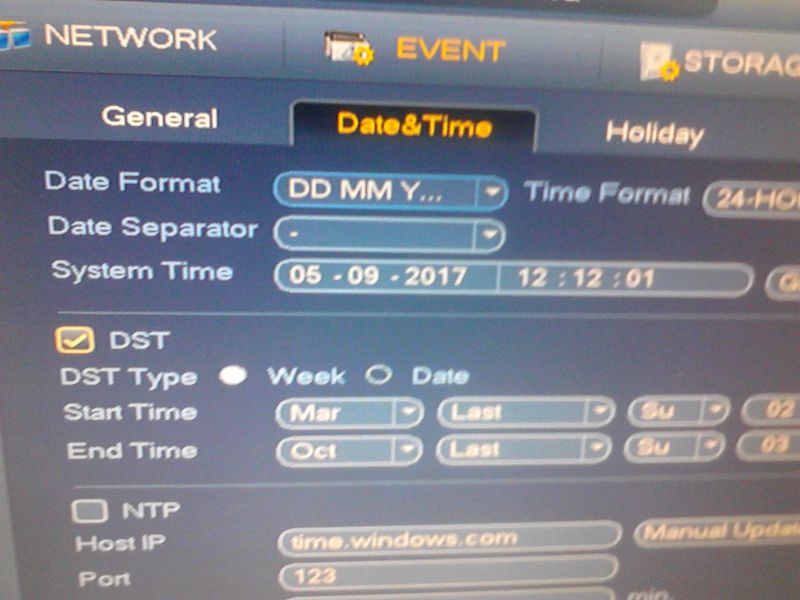

I have DVR HCVR7108H-S3 and i updated firmware to newest from dahua site V3.218. But there is problem
-from web browser and smartPss when access with admin credentials can view and play footage, but
can not download footage , can not access setup, info... (message have no rights)
How to downgrade firmware, or to access setup.
P.S. in 888888 local i can access and other., screenshot time date in attachment
