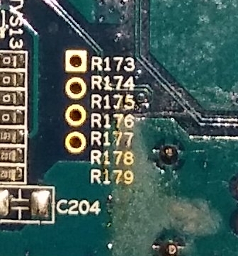

Сообщение iTuneDVR » 22 фев 2016, 21:59
Make MB photo in good quality like in viewtopic.php?t=641#p2020
All must be easy.
But if you already brake bootload, you nothing to see via TTL.

this better?
Re: 3104P NVR Bricked
Сообщение iTuneDVR » 22 фев 2016, 23:17
YES! :)
What on pins in inside white plastic?
Сообщение iTuneDVR » 23 фев 2016, 00:26
What is your TTL2RS232 adapter? COM, USB?
Possible this.
(possible +5V), Gd,Rx,Tx
Testin it, but if no luck, need reflash with full image.

iTuneDVR писал(а):What is your TTL2RS232 adapter? COM, USB?
Possible this.
The cable is TTL2RS232 USB.
+5v is the square conection?
Сообщение iTuneDVR » 23 фев 2016, 01:21
chamek писал(а):+5v is the square conection?
You have power tester at your hand?
Test all thiese pins!

Сообщение chamek » 23 фев 2016, 01:23
ok i will try no power need or do i need to plug it on electric?
